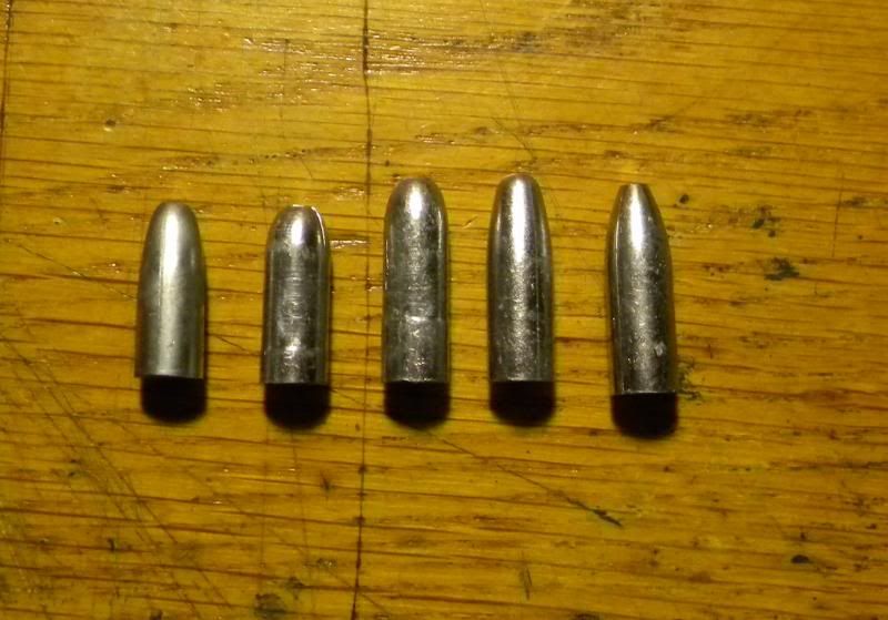

Jim here's a not real good pic of the 44 slicks I've used, the 434470 is the second from the right
[Image: 001-8_zpsfa22ba17.jpg]

Don,
Is that 434470 the mold that BACO sells? I like that one and the middle one (2-D).
I will most likely be ordering the BACO 430520 which I believe has the same nose as their 434470, but it is a length better suited to my 17-twist barrel. I'm holding back on any more molds until I have the rifle, there is no point in getting too far out in front of this. I pretty sure I'll need it more at .432" diameter, which if I understand correctly BACO will do for me.
The two molds I have now cast at .431-ish and patch to a half a hair under .438". That should get me started even though they are a bit small in diameter.

Yes that’s the Buffalo arms bullet
I had a 432 diameter bullet but found it to not work well beyond 600
That’s when I asked Dave about making this 434470 and it is a. Good bullet
I really like the verticals it holds at 1000 when cast from 16-1 and wrapped in 7 lb in the 17 twist barrel
That dual diameter is the same as I brought you when I was in Lodi
Actually been thinking about asking Brooks to make it in a base pour with that original postel nose
