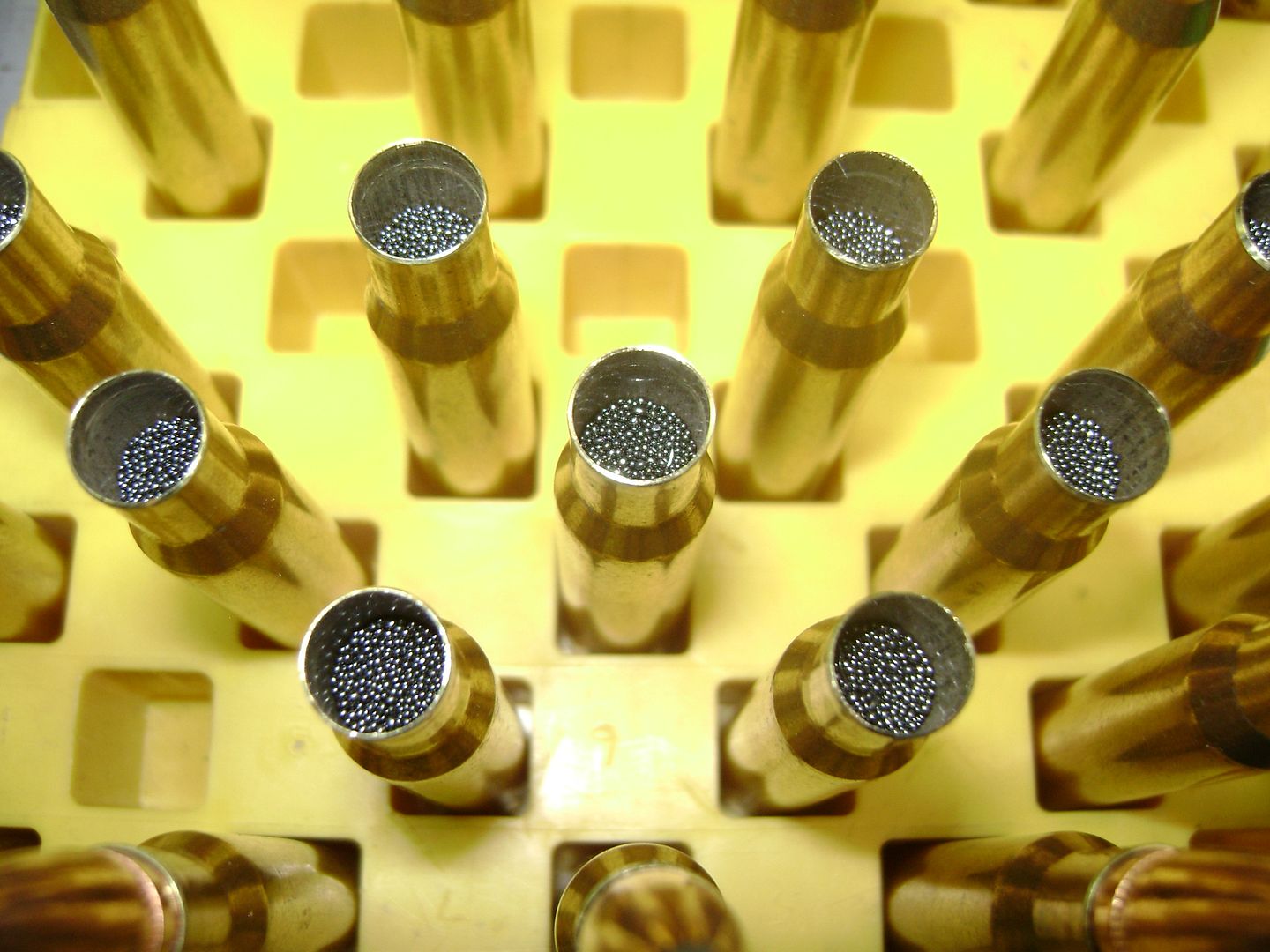

I took no pictures of the trimming, etc. Now for the charge.
[Image: DSC04062.jpg]
[Image: DSC04064.jpg]
[Image: DSC04067.jpg]

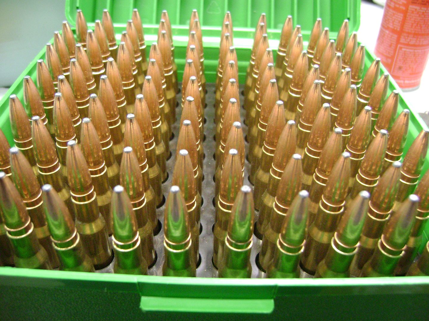

Packaged & ready to go.
[Image: DSC04080.jpg]
[Image: DSC04081.jpg]
