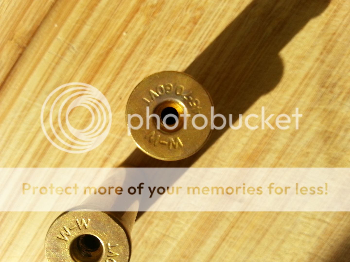

Last Saturday I was having a nice Range Day

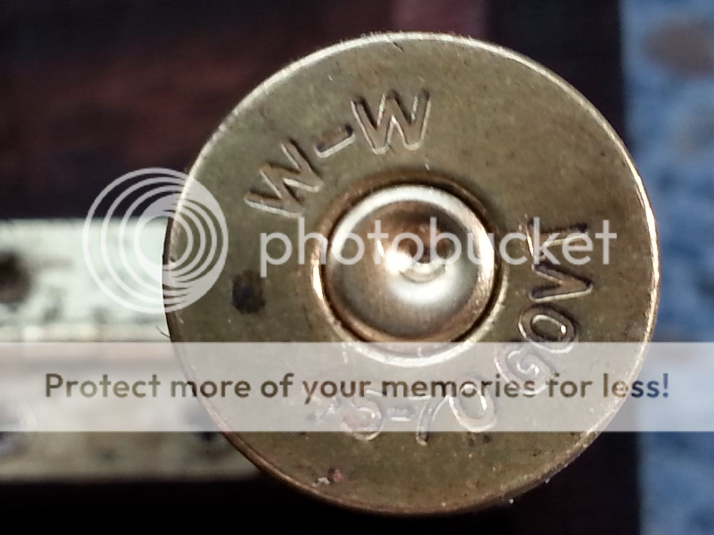

My Load :
70 grs Wano Black Powder Nr. 1
S&B Large Pistol Primers
Winchester Case, fire formed
Flashhole open to 0,125 inch
No hints about high pressure

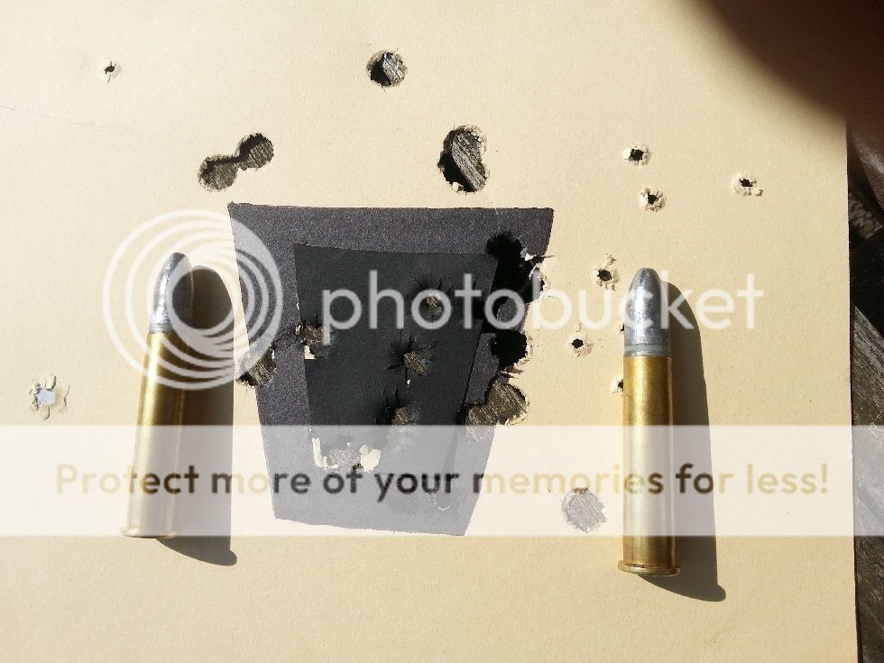

Distance: 100m
Sitting
Cross Sticks
[Image: 20160409_155533%20-%20Kopie_zps49jf0wia.jpg]
First 5 Shots are high by light condition at this day ( sunny )
Rear sight adjustment done by two times and following 15 Shoots
13 hits the Bucket but one flyer right side and one flyer high inside the triple hole was my mistake.
No wiping between shots only use of a blowtube
Need two dampened and two dry patch to clean the Barrel

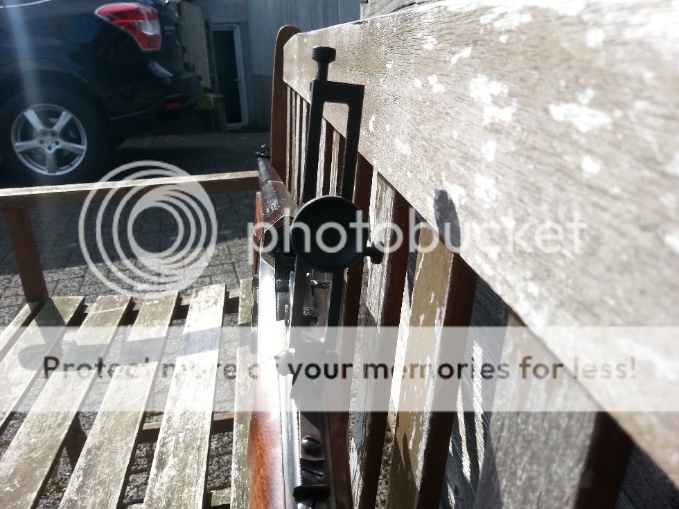

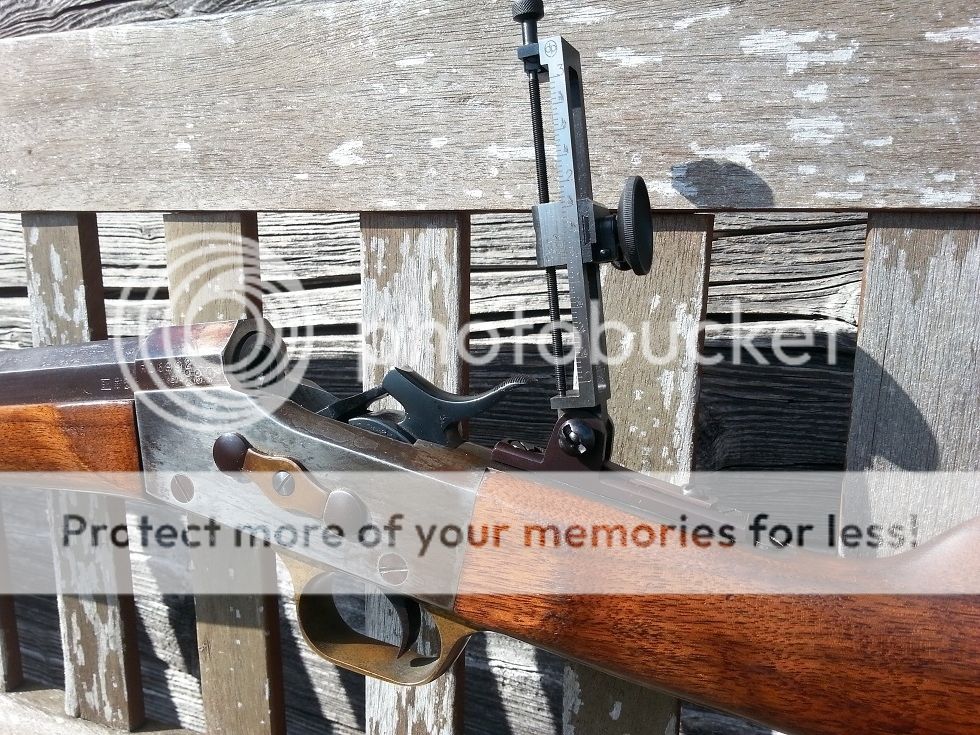

Pedersoli Rearsight 430

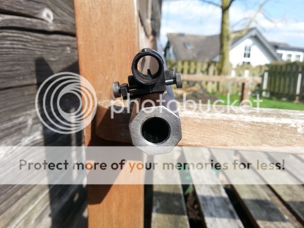

Pedersoli Globe Front with a Post Insert

Big Grin looking pretty good Klaus.
04-13-2016, 06:05 PM,
RE: Range Day with Pedersoli Rolling Block Sporting Rifle Cal. 45-70
NIcely done Klaus !!!!!!!!!!!------------just a rough judgement on my part but it seems about a 3 minute core group ?-----am i close ?

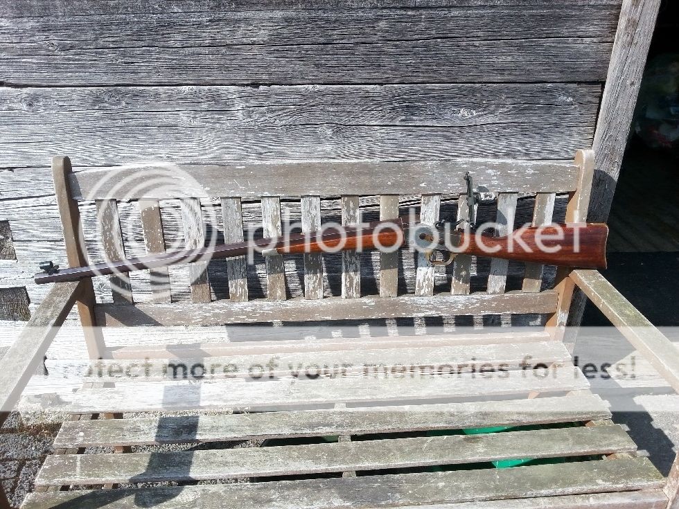

Nice! Did you distress the finish on the action? I like it.
