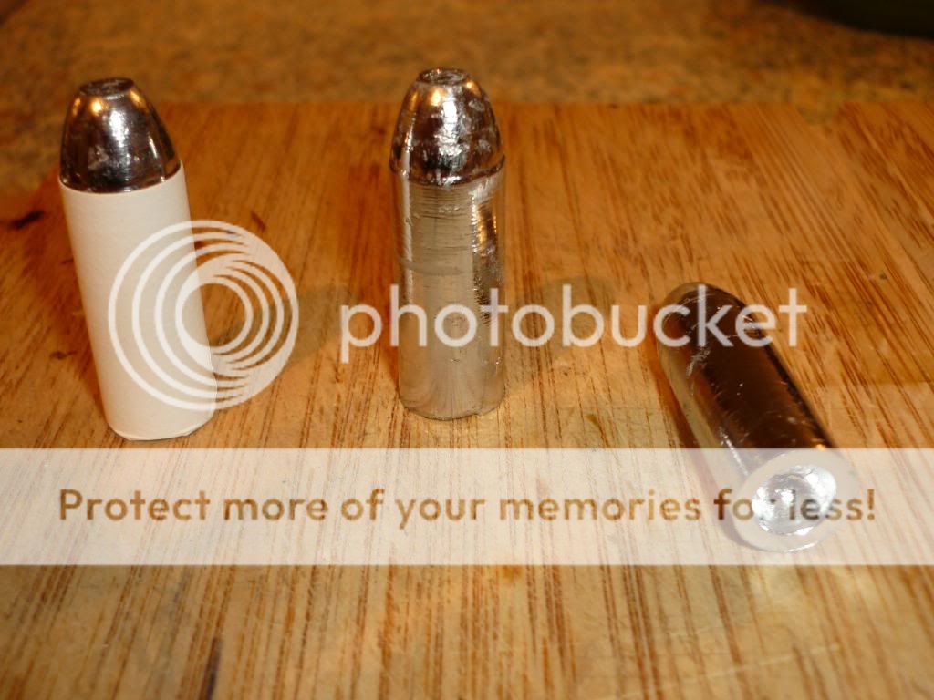

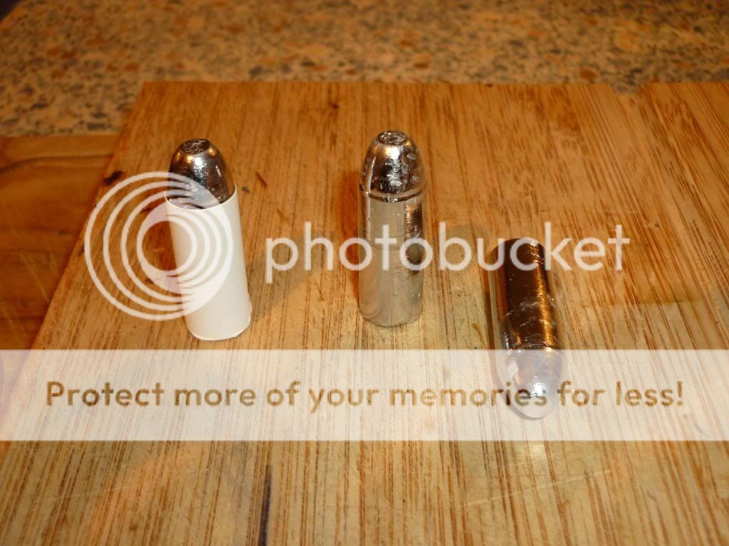

Cast soft Lead and wrap with Airmailpaper.
[Image: 002_zpsee2fd287.jpg]
[Image: 001_zps86310871.jpg]

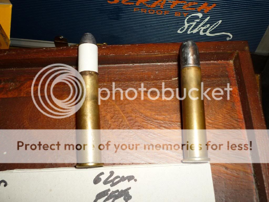

on the other side the well known Lyman 457125 Bullet
[Image: 005_zps6ed25a01.jpg]
Load with 65 grs Wano Sporting Powder FFFg for the PPB and 62 grs for the 457125.
[Image: 003_zps26b69840.jpg]
The loaded Cartridges
[Image: 004_zps5d1de811.jpg]
