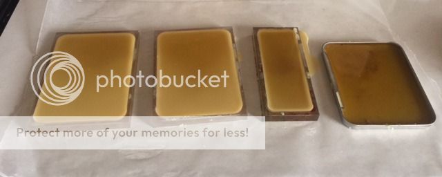

I'm making a few cakes of lube today. This lube is made up of 1/3 beeswax, to 2/3 by weight of Jojoba oil. It works very well for hunting.

That jojoba oil is some handy stuff.

My wife was in class today that's why I made lube in the house Big Grin. I think it smells good. The boys thought I was cooking something. Thanks for the advice.
04-16-2016, 09:36 PM,
RE: Lube
Tongue I bet it smelled like honey Tongue
04-16-2016, 09:52 PM,
RE: Lube
They thought I was making corn bread with honey on it! Smile
