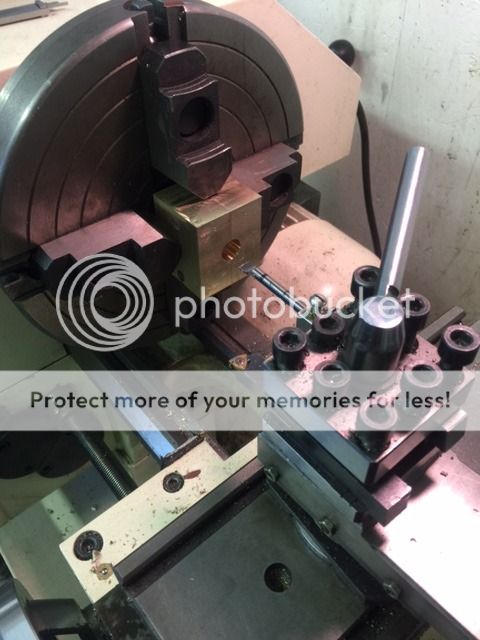

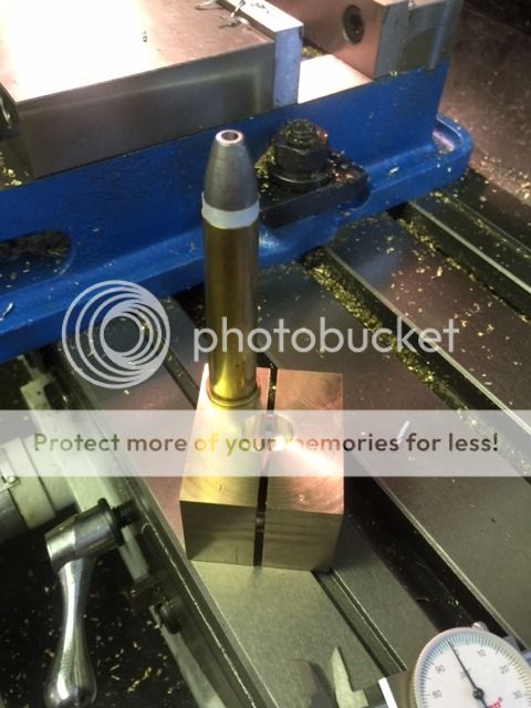

After seeing Daves little bullet clamp I had to make one. Found a little time yesterday and today to build one. The bullet went from 469 grains to 429 grains. I quickly drilled the hole in the meplate of the bullet so it's a bit off center......had four hungry boys wanting Dads homemade biscuits and gravy, so time was of the essence. I will be interested to see how accurate it is if at all! If it is then I will be curious to see how it performs.

Hey Stephen GOOD JOB !!!!!!!!!
With the Mill you can center up really well and quickly Smile

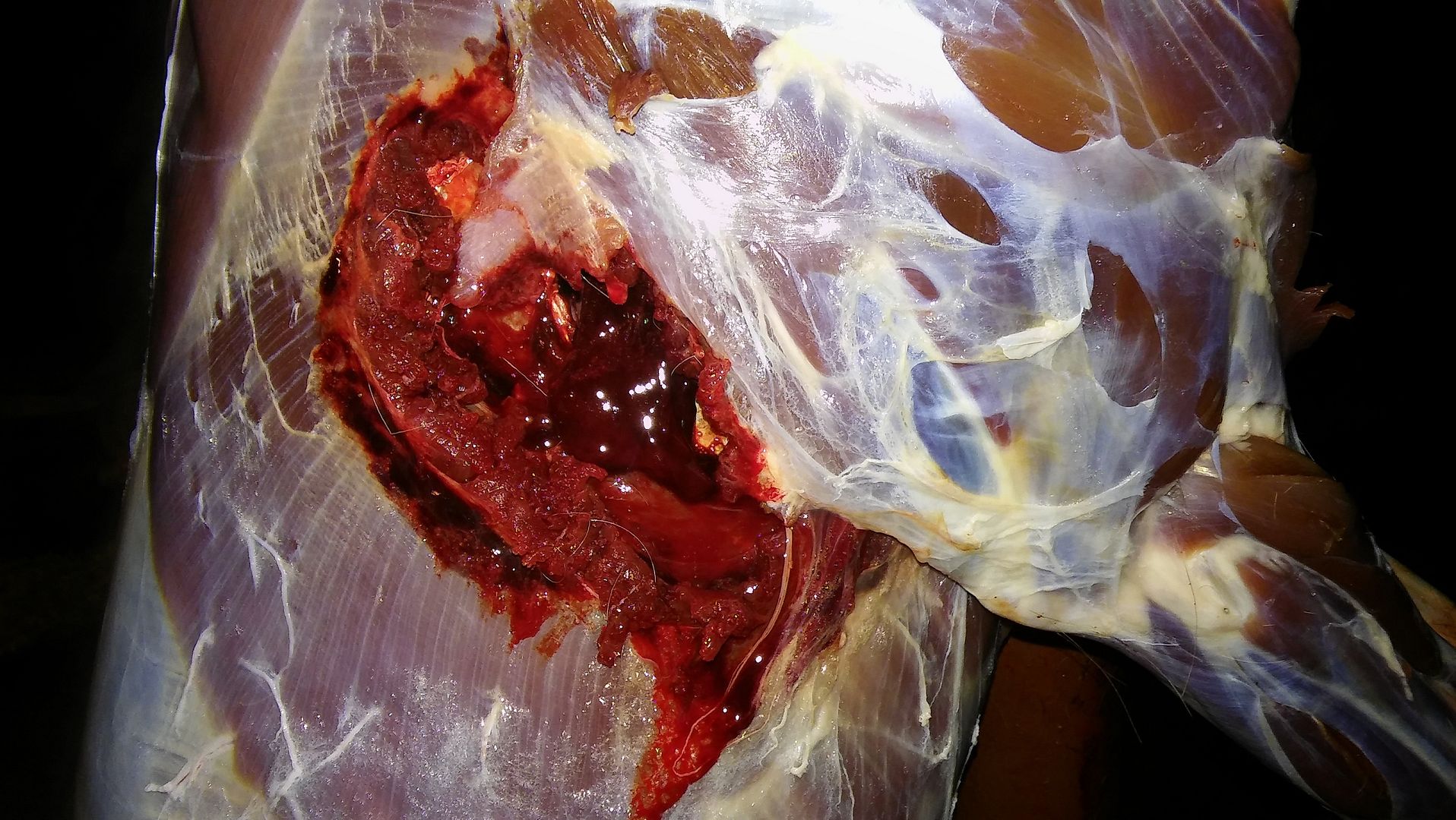

Big hole in, lots of meat damage, bigger hole out, if it makes it all the way through. If you manage to get hamburger, it will be bloodshot.
I found this out using a 340 grain Gould hollow point years ago, and when I hollow pointed a 520 grain Govt bullet, it didn't help too much in the blood shot meat dept. I don't think you're gonna like it. Shoot straight, rdnck.

Rdnck's exactly correct on the damage side, this pic gives you an example of what you can expect----It did reduce the "run after shot range" from 50 to 100 yards to under 50 yards.
[Image: 20151205_210241.jpg]
This is the "offside" the "onside" was the normal 45/50 caliber hole
I made the fixture to play with at the house---its doesn't even mar the bullet surface----collets were a bit inconsistent for me specially with soft lead.
Sam: just for grins i rolled the bullets on blades to see if i could find any imbalance---when truely centered the bullets shot well out past 200 yards Smile----it is a bit tricky to get the fixture lined up, when it is its very repeatable with simple stops
Keep safe

Dave, it may depend on the collet that your using. If your using 5C collets they they most likely vary and damage a little due to the way they work and are designed. The ER collets are a little different, but like I said I just popped a 1/2" collet in the chuck to see if it would tighten up on the 45 bullet and it did.
As far as getting your fixture lined up, I would probably use a dial indicator to dial in the spindle to the bullet, but thats just me, being an old tool maker doing things that way had become habit over the years.
