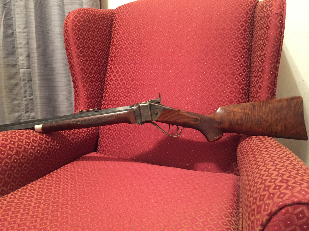

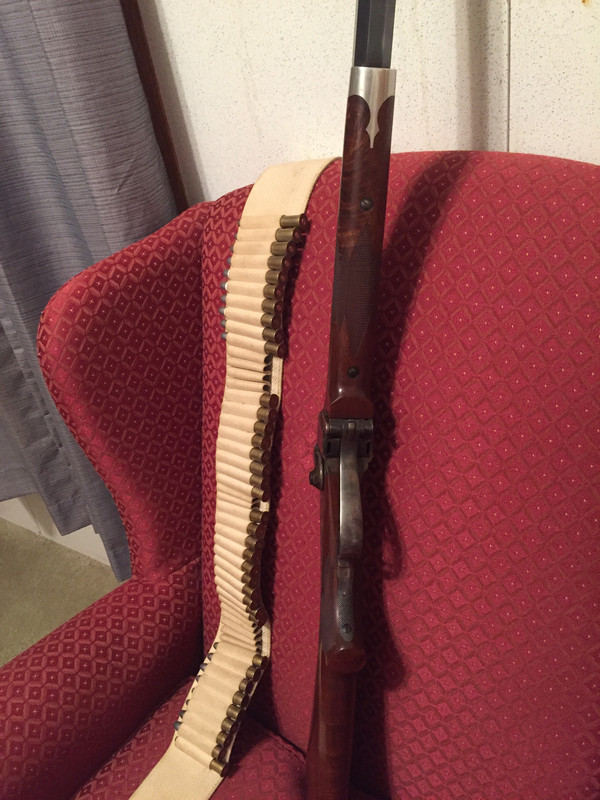

			<description><![CDATA[Picked up the Shiloh Sharps .40-70 Straight today that I bought from Bill’s wife. It is a beautiful gun and while I never met Bill in person he spent a lot of time talking to me on the phone and helping me with my learning curve when I first started with BPCR. He saved me a lot of money and aggravation. I hate that I never got out his way to take up his invitation to come shoot at his house. I considered him a friend and am grateful to be able to own one of his rifles. These are pics that Sidra sent me when I bought it<br />
<br />
<a href="https://postimg.cc/vgGkzDvG" target="_blank" rel="noopener" class="mycode_url"><img src="https://i.postimg.cc/zBhNqgbH/02E3A735-A436-448E-88D9-06D3B70DA546.jpg" loading="lazy"  alt="[Image: 02E3A735-A436-448E-88D9-06D3B70DA546.jpg]" class="mycode_img" /></a><br />
<a href="https://postimg.cc/QKtz2PPP" target="_blank" rel="noopener" class="mycode_url"><img src="https://i.postimg.cc/zvS1gYkJ/6EC60996-1E01-45DA-A0F4-B32470E3DA8D.jpg" loading="lazy"  alt="[Image: 6EC60996-1E01-45DA-A0F4-B32470E3DA8D.jpg]" class="mycode_img" /></a><br />
<a href="https://postimg.cc/8sPxfJ5H" target="_blank" rel="noopener" class="mycode_url"><img src="https://i.postimg.cc/WpMVK0cQ/C3307C60-D677-485C-B86C-D70FED8924B6.jpg" loading="lazy"  alt="[Image: C3307C60-D677-485C-B86C-D70FED8924B6.jpg]" class="mycode_img" /></a>]]></description>
