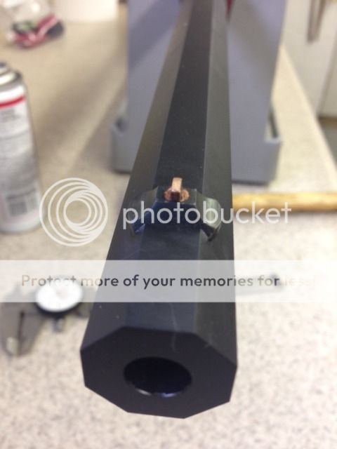

07-25-2014, 06:34 PM,
#25
RE: Hartford front sight
[Image: photo_zps0c432925.jpg]
Got busy and built a front sight for the 40/50, Kurt yours is next.
07-25-2014, 08:43 PM,
#26
Stephen, that is a very nice looking front sight. Is the post Copper or Bronze? Pressed in or screwed in?
From the looks of things you do some very nice work.
Sam
07-26-2014, 12:52 AM,
#27
Thanks Sam. It's bronze and I make it about .002 tight press fit.

Sam, I forgot to mention, the originals were staked in on the base of the sight.
Thanks
