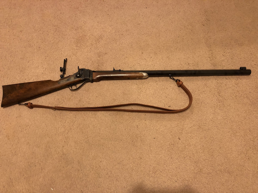

RE: Another period correct Buffalo rifle in .44-77 - pacecars - 05-20-2019
Picked her up today!
[Image: E51-DB84-F-1-E2-A-4139-B19-E-F468-EDD21137.jpg]
RE: Another period correct Buffalo rifle in .44-77 - Dan Cash - 05-21-2019
You have a fine gun. How does it shoot?
