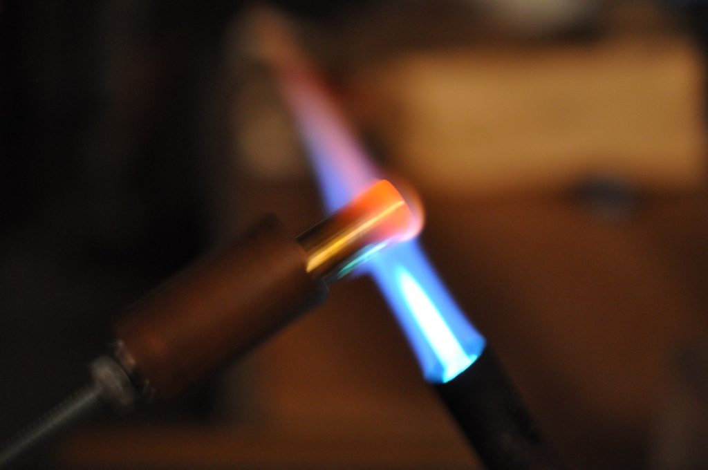

RE: Annealing........ - Willy - 05-10-2012
Just thought I'd add some color to this thread Smile
[Image: anneal5.jpg]
