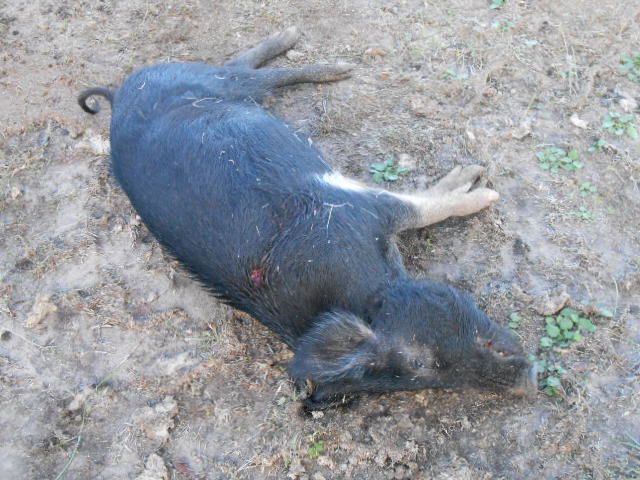

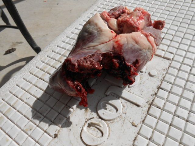

A little later in the day the deer critters beat a hasty retreat to the thickets and this nasty ole boar hog showed up---------------i put the 375 paper patched NOE bullet through the near shoulder as he quartered to me-----------he bolted at the shot and made it perhaps 50 steps and collapsed in a heap, must had expired running because he didn't twitch after he piled up.
The 375 paper patched bullet is most likely burried in a tree down range !!!!
The load is 375 H&H 270 grain NOE bullet out of air cooled wheel weights 2% tin, wet Paper Patched using composition pad paper sized to 0.3765 O.D.---52 grains of 3031, 1 grain of dacron fiber fill---CCI BR2-----into the rifling perhaps 0.002
I can't comment on any expansion, however in the quest of a DRT load i think i'll cast a few using 50% WW and 50% pure lead + 2% tin----------might even hollow point one or two cavities of the 4 cavity NOE mold
Next trip will be a kids hunt for Thanksgiving weekend a Buck or two are destined for the grill shortly after Thanksgiving
[attachment=448]
[attachment=449]
[attachment=450]

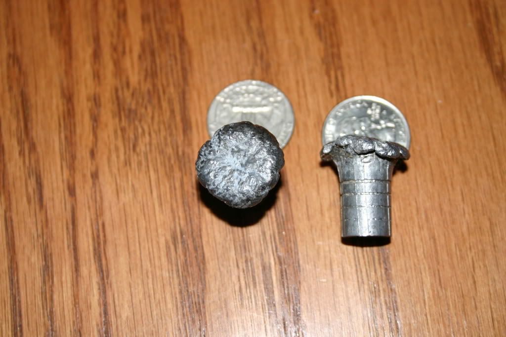

RE: The beginning of the season - Kurt - 11-16-2014
Dave.
Using a mix of 50/50 WW/L you will not get the expansion you think, especially if you add 2% more tin.
Look at the recovered bullets in that picture. The intend of those recovered bullets was to see the setback o the nose not expansion but I have tested to see what the expansion is shooting into a box of gunny sacks.
WW have more then enough tin and antimony to hold the integrity of the bullet ogive with a 50/50 mix. The mix of 50/50 WW/Tin holds the bullet just as well as 1/18 tin/lead.
Those bullets marked 95/5 1/40 is 1/2# roll of no lead solder that is 95% tin 5% antimony added to 20# of pure lead. That small percentage of antimony holds the nose a lot better then much more tin.
[Image: IMG_1295_zpsc27099f7.jpg]
